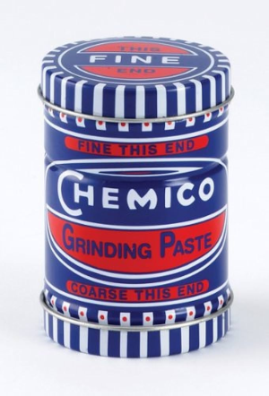

I seem to remember Blake's recommending a particular grade of grinding grit to ensure that some grease is held captive in the cone and body. So your pits can hold a nice quantity of grease.
