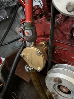

Hi there
Beta 20 has a small water leak just behind the impeller. The small video here shows more detail, ignore the first few secons that is me (not a pretty sight)
Thoughts please, does this look like the impeller, water pump or somthing else?

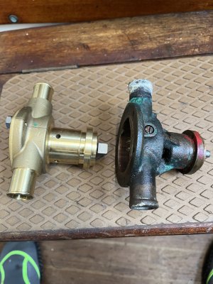

I have just ordered a new pump from betamarine.co.uk
part number 207-61500
O ring part number 209-08266
I did ask about guides for fitting and the response was - I don’t have any diagrams for changing the seal. I have attached photos of the pump stripped down. I believe it is just a circlip behind the impeller, which holds the seal and shaft in place. Can anyone confirm this if that correct?

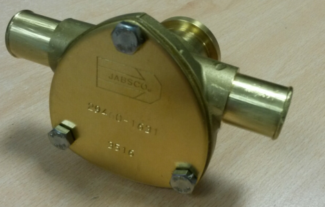

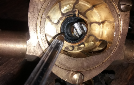

I had exactly the same symptoms, all that was needed was to replace the lip seal which I was able to do without removing the pump itself, it's just behind the impeller. I got a service kit from Germany here, only used the lip seal and replaced the lip seal from the kit with the same off Amazon for a few quid. ASAP wanted £20 odd just for the lip seal. As above it's important that you get the seal with stainless spring and that you get it the correct way round, I found this video helpful...

dont know about this particular pump, but small jabscos frequently have the seal backed up by a retaining o ring
