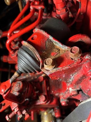

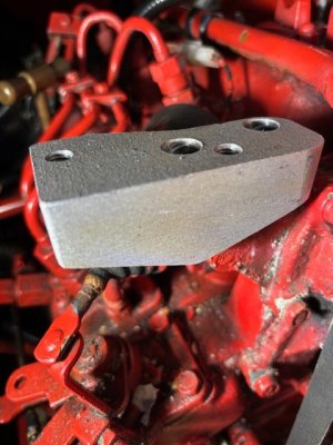

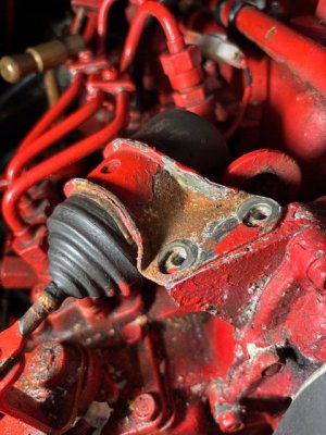

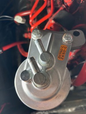

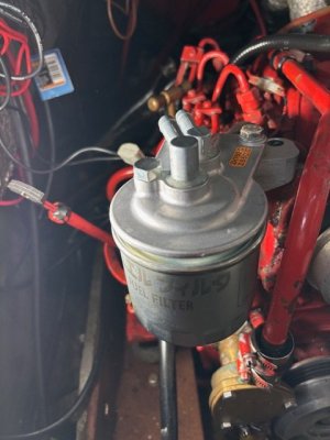

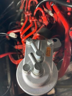

I managed to fit the adaptor this weekend, ran out of time to fit the pipes and bleed the line, so next week for that. Nice and easy so far

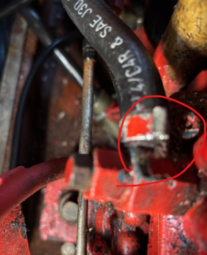

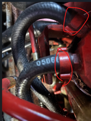

So a frustrating day this was. I tried to remove the existing fuel lines and run new ones to the adaptor a installed last week but I could not budge then.
Can anyone explain how to undo the clips shown in the photos please.
