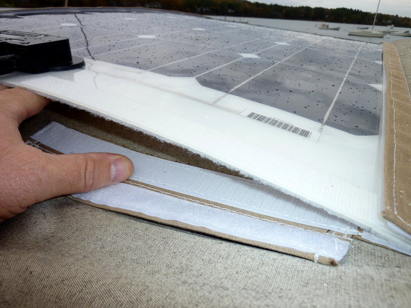

Google Solbian velcro,
Hi
We found that velcro was not secure in a blow. I stitched a small patch of matching canvas top and inside with a small stainless "D" ring at each corner, nylon cord then fixes the solar panel securely to outside. Maybe not so neat as velcro but safe.
Good luck
Having been testing the solar panel on the bimini by, well, having it sat there, we're pretty happy this should be fine. The panel isn't massively heavy and the weight distribution between two of the bimini supports seems to be good. So we now want to secure it like in the picture above, which looks the neatest and safest. It should also help distribute the weight of the panel and provide some rigidity to the bimini, as opposed to anchoring at the four corners alone.
