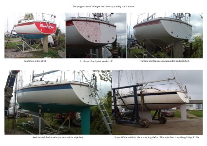

As vyv cox stated, paint will never be as hard as gel coat. As to removing paint from gel coat, when I bought Concerto she had a red painted transom. It took me 4 days to sand through 5 different colours of red paint and then compound the gel coat back to a high shine. Strange that everyone told me just to paint it white, but when they saw the results everyone agreed I was right and they were wrong.
