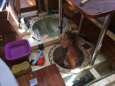

My limited experience on three French yachts from the 1970s was built in tanks in awkward corners with no access to clean
geem
27 Apr 2006
7,740
Caribbean
This one is the water tank. 800 litres. Two access lids. You can see that you can climb in. The diesel tank is just astern. 500 litres. Only a single access lid on that onereceived_395706550282994.jpeg
