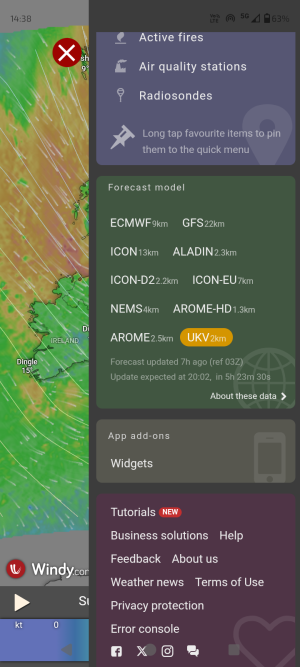

As to the predictability of individual cells, you are correct in that we are not really there yet.
But both HRRR in the USA, and the French AROME HD model are actively trying to do this, and they are getting better. It is an explicit goal of the models. The current AROME HD is a pretty new version and HRRR is scehduled to be superceded soon. UK Met also has a very high res model (UKV), but I Don't think it's eay to get; I have never used it. AROME HD covers a lot of GB and Ireland.
I use both quite a bit for racing and cruising. When I see a strong cell on one of them, I do not only say to myself; "we have conditions for strong cells tonight".., rather, I pay attention to the exact location and timing of the cell. Mostly, I am using them just for wind and wind shifts - they are freakishly good on some occasions...
In terms of the easily available versions of these models, they have their differences; Arome is higher res (1.3km), but HRRR is run more often. HRRR is re-initialized and a new run produced every hour, while AROME HD is 8 X a day. HRRR is even available publicly at 15 minute time steps. Both agencies run the models internally at higher resolutions on nested grids that follow individual storms.
The MAIB report does not mention the AROME HD forecast for the night of the accident, but they must have acquired it.
Knowing the speed at which supercells develop and their small size, I have to doubt the practicality of what you say.
It would certainly be interesting to know what AROME produced. Meteo France must have the information. Like UKV, I assume AROME is run hourly. I think that a run using, say, 1800UYC data is available at 1900. A supercell could have done its business and disappeared in that time frame.
