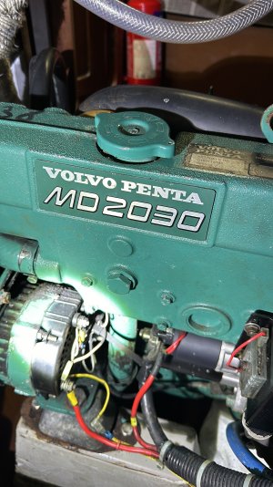

Hi I have a Bavaria 38 sailing boat 1999
And my Volvo penta md2030 engine won’t start .
I was unable to get to my boat this season till the weekend .
The boat has been with electric on pontoon all winter but not turned over . It did reluctantly start after a few goes but then after running it for an hour then leaving it over night it reluctantly started the next morning , took it out sailed for two hours then would not start , batteries saying full .
now back on pontoon and it won’t start at all after a very decent 1.5 run .
Can anyone help please ?

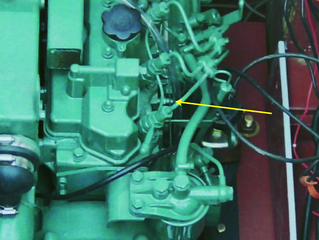

Can you please indicate where the glow plug is on the engine please ?
tillergirl
5 Nov 2002
8,486
West Mersea
Drawing1 by Roger Gaspar, on Flickr
One illustrated. There are three below the injectors. They are very easy to replace.
With no life at your starter motor I think your first action is to check the terminals on the starter motor. For me, it looked fine but when I undid the negative, cleaned it (which didn't look like it was dirty) and redid it and that solved the problem. Then check your battery connections. They might look ok but mighjt be in need of remaking the connections.
Do you have a Both-1-2-off battery switch. Again they can fail to provide sufficient power to the starter. This failed after many years of use:
