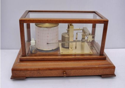

This arrived this morning, I cant wait to get it up and running

That's a good looking piece of kit. Quite a lot of electronic barographs around, but nothing beats the tactility of paper tracking.
Somewhere under the office desk I have Casella museum instrument. I'll post a photo when I return from a car journey.

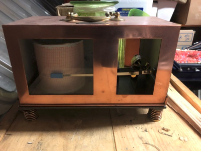

I have an ancient thermograph which I built up from a box of bits hoping, when I was given it, that it was a barograph. Note the spring loaded feet. I suspect it was originally installed somewhere prone to vibration, perhaps a ship's engine room.
I converted it to felt tip pen as it's a lot less messy. @Darmik, if you want a bottle of ink drop me a PM with your address.

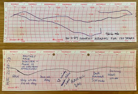

I was looking through the old charts that were in my Barograph drawer, and came across these two….
