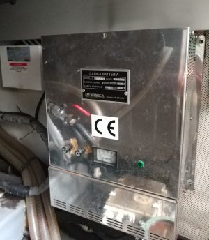

Old Azimut main charger, 12V, 90A - on Plate, but we mesure only 3 to 14A overall, fuses ok checked

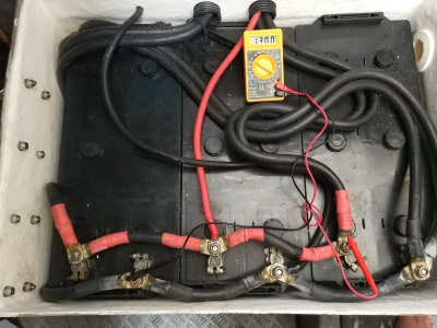

The 3 main service batt., lead acid, noname?, old/no date?, loose capacity within 5 hours of no load ...:

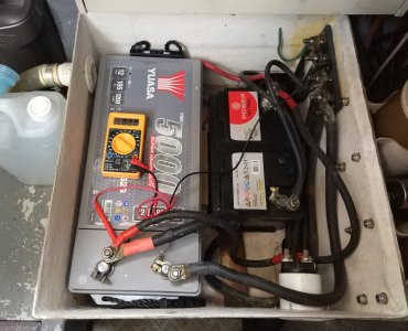

The engine + generator starter batt:
So, what? You can't be sure that the charger is defective based on the fact that it puts out less current than the max it's rated for, because that may be all the batteries can take.
BTW, I'm asking because I had the same charger on my previous boat of the mid 90s, and while it's rather agricultural when compared to modern stuff, it's pretty much bulletproof.
In fact, the only reason why I replaced it with a Victron Multiplus a dozen or so of years ago is that I wanted to have also an inverter, and while I was at that I used it also as a charger.
But the new owner of the boat confirms me that the old charger (which I left wired as a backup) is still working as it should, even if 30+ years old.
Trouble is, that alone doesn't give you any status monitoring, aside from its tiny and very rough ammeter visible also in your pic.
That aside, ref. your batteries pics:
1) what do you mean exactly by lose capacity in 5 hours under no load, for the service bank?
The multimeter shows 13V, which isn't enough to assess the batteries conditions, but as such it doesn't confirm they are bad, either.
2) in the engine & genset batteries pic, I guess the multimeter isn't properly connected, because no voltage at all is unheard of - and pretty sure not enough to turn any engine on! 😅
Besides, the wiring looks a bit odd. Is the disconnector visible at the bottom right of the pic meant to start the genset with the engine battery, should the smaller genset battery fail?

Sure as I said the old Dynamica charger is decaying , throwing out “ 3-14 “ despite having a 90 A label .
Yes - there was load around 38A x 5 = 190Ah .... full should be +/- 600Ah and batt went to 12.2 V
Multimeter was NOT connected! = 0.00
The switch at the bottom connects both batteries together.
Nice berth btw .
Well - the old Dynamica charger will be gone next week!!! - It has no control over the charging curve as has a new Victron Multiplus 2.

BTW, how SF can tell 3 from 14 (or whatever) based on that ammeter is a mistery to me.
The ammeter on the Dynamica seems not working - dead, also the green lamp is dead. I will no more investigate into this old piece of electronics.
Measurement was done with a real, external ammeter.

Even if you want to stick with Victron batteries, you could buy 400Ah of LiFePO4, an Orion XS 50 to charge them, and a Victron Multiplus 1200 charger / inverter. You would have more usable battery capacity, much faster charging, a 230V inverter for “free”, money left over and you won’t be replacing them all again in a couple of years time.
There is no need to worry about how to fit them, they will take up so much less space than the old ones it’s irrelevant.
I've said pretty much this twice. Expensive lead acid batteries make no sense for most installations, certainly not in this case.
BTW i think one of those silly money batteries is for engine start, he only has room for 3 domestics.
