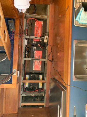

Azimut 46 - new battery charger system plus service/house batteries, engines battery and gen. battery
Skipper Felice
24 Sep 2023
234
Italy - Switzerland
Some experience and helpfull information - tips will be gratefully received.
On my boat - Azimut 46ft, year 2000, the last owner did not do god maintenance for the electrical system: I have to replace the whole battery and charger system.
The whole energy system should power the boat at anchor for 2-3 days. For offshore I can use the generator to recharge if needed.
Based on various information I will not go for lithium battery systems.
I plan to use VICTRON charger for shore connection (32A) / KOHLER gen. output 220V, 7kW. All management components from VICTRON.
Whole system is 12V.
I will need 3 x 220Ah service batteries. (+/- 650Ah total) (deep cycle?)
I will need a new engine starter battery, high current, +/- 200 Ah (for Caterpillar 3208 engine)
I will need a new generater starter battery, high current, +/- 100 Ah (for KOHLER 7kW)
What type, brand or supplier do you recomend for good, reliable batteries? What is your experience with different batteries on a motor boat 50ft?
I have marine lead batteries for engines and starter, for service gel (4x200ah), the type used for solar panel installations.
I need in average 14 Ah to keep fridges etc running, I converted all 40-odds lightbulbs to led (they where halogen before, 20w each...) so going down to 50% battery we have around 24 hours before the generator has to start again (longer if not so hot, if noone opens/close the fridges 20 times a day etc).
The battery charger is from Dolphin, it loads 60A x 24v or such max so that we need to run it 3 hours or so to get the batteries to 90% (after that the charger will start loading less and less so its a bit of a waste to let the genset running).
I thinking of installing an inverter so that we can charge phones/laptops or run a simple fan instead of aircon, maybe a project for this winter...
We have 24V for start and domestic, with some 12V instruments on the upper helm.
When we bought the boat, like yours, the batteries were done, charging them up triggered the gas alarm so we replaced them, the original ones were 2 VMF semi traction 230Ah in series for 24V they had no balancing of the charge between them and one battery took all the charge and left the other low, replaced them with a pair of Varta semi traction 260Ah with a Victron battery balancer to even out the charge and provide a bluetooth battery monitor. The Varta batteries will be in the boat for a year come Sept.
A friend with a 50' trawler yacht has just changed out his VMF batteries, which were the same model as in my boat, a couple of months ago, I helped carry in the 6 new batteries for him, they did not last long he said and was a bit disappointed in their performance.
We have some sockets on board that are only powered by shore power, while the rest are connected to the Victron Multiplus Compact 24/2000/50 inverter/charger which also charges the start batteries with 24V @4A the batteries are also VMF of 12V 680ccA so far they have fired up the engines in less than one revolution. There is a 50A 24V to 12V converter behind the fuse locker to provide for the 12V systems onboard.
Took a while to sort out with both the original installer and Victron and get the system to work properly, from everything I can now see I don't think there was much maintenance done on the boat between the owner passing away in 2020 and the estate getting the boat ready to sell in 2024, she had been stored out the water for over a year only going back in with two new propellors in May 2024 and we bought her in July 2024.
Next we want to put solar panels on but have not researched it properly yet.

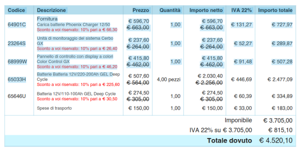

I just got the offer from a dealer in Italy, all components Victron, and Victron GEL batt. / What do you think?

Matteo from “ Doc Yacht “ on the marina will supply , fit and take away old batteries.
He will know a boat electrician too who will do as assessment first . Inc your charger .
This stuff is better accessed by a professional imho rather than random armchair key board warriors .
You new batteries need to dimensions wise - fit into the boxes and have the same pole positions for the connections.
Mail order or an out of town guy carries risks they won’t fit .
Matteo has 100 s in one of those garages by the sea wall ….his lock up .
We had a 120 AH Dolphin charger for 2x 180 Ah domestic and the same engine starters .
The original was a tiny 30 A .
These days modern chargers have multiple stages inc trickle - maintenance + many more . Tend to look after the batteries better than chargers of old .
Additionally your engine alternator (s) output needs figuring out …..so you have an idea of what’s going in the battery banks when running/ cruising .
There might be console gauges to indicate this ?

And mine is from 1978, it came with 24V and 12V for domestic and 24V start as standard from new, though the original batteries were 6V each, I have space for one more 12V 230Ah size battery in the battery tray which is under the galley floor.
Trying to revive the dud batteries, didn't work though.
I’ve got one bank of 4x 12v in series/parallel for domestic, plus two banks of 2x12v in series for each engine start, plus a single 12v dedicated generator start, plus a bank of 2x12v in series for bow thruster. Victron AC (shore or generator) to 24V charger for domestics; CTEK AC (shore or generator) to 12V charger for gen start; DC-DC Victron charger for the bow thruster batteries; plus alternator charging for the engine start batts. I think I know what I’ve got but I’m very hazy on how it’s all connected up and charged.
No BMS.
I’d love some kind hearted volunteer to crawl all over it for an hour or two and draw it out.
No BMS.
I could probably help?
Honestly, nearly 2.5K for 4 batteries is madness. 2 x 314Ah Lithium batteries (not Victron) would be vastly cheaper and give you more usable power, take up less space, weigh less and charge much, much faster. Not sure why you are so against Lithium, but if you're dead set against it, just fit cheaper lead acid batteries.
