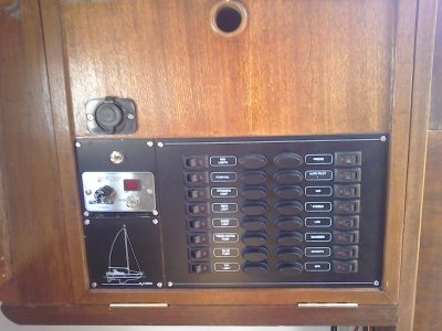

when you say "main board" do you mean after the isolator. My 3 position switch is physically on the main panel but is wired positive direct to the positive bus bar before the isolator. as you can see I laid out the panel to take it.

There is a danger of making this all too complicated. Important to have an automatic bilge pump live at all times so it must be wired direct to a battery. The physical location of the switch is irrelevant, I just designed my panel to have it physically located there but it is independent of the switch panel with the positive going back to a busbar in the positive for the house battery before it gets to the isolator. The same bus bar for example takes the positive from the mains charger and if I had solar would also take the feed from the controller. On the last boat I rewired I had a dedicated always on box which was essentially an enclosed bus bar and I had the pump on that plus the tiller pilot, although I would not do it that way now.
