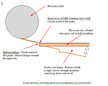

Thanks for your response. The reply is that everything else seems rock solid. The floor underfoot is extremely firm but I can see into the hull. What could I look for or tap for?
Take a big mate with you, and get him to lean inwards and outwards on the buoyancy tube, while you look for any movement in the cracks. The hull is pretty well supported forward and aft by the structure of the buoyancy chambers under the floor, but these hulls can be prone to 'hinging' amidships around the outer edge of the rigid floor amidships, in the position indicated below.

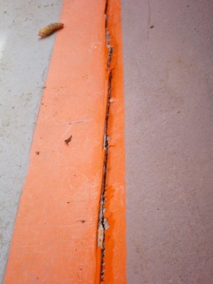

Found this around the edge of the floor (under the buoyancy tube) inside of a 535 from 2007, which had less than 100 hours on the clock.

That seems to be to be quite a lot of cracking in a very localised area. As others have said, it is not unusual to find stress cracks on a rib, but that many all in the same location would concern me and I would want to know more before committing. Is there a similar effect on the other side of the boat in the same location? If not then it could be a result of some form of impact damage just on that side.
I bought a new rib many years ago from a local cottage industry company and it started displaying very similar cracking. After a bit of negotiation they took the boat back and built a replacement hull after claiming their laminator had left out a layer of glassfibre in the original.

IIRC it was one of the first ones built in SA, and it turned out to have been built in a rush to get it shipped to the Southampton Boat Show on time. But the poor lay-up in that example just exposed a known weak spot of many RIB designs of that era; more recent designs have much better support in that area.
