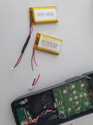

I'm satisfied that in a densely populated area like the Solent with active CG stations that they don't need my help acknowledging a mayday, particularly as my boat is stuck in a cradle on the hard at the moment. VHF switched on as I had just replaced the battery in a B&G handset with a Chinese Ebay special and charge time has gone from an hour to two days ;-)

The cancelling of DSC alert messages (not maydays) whilst on the hard and my buddy DSC calls are mutually exclusive. Radio was on for receive only testing purposes.
