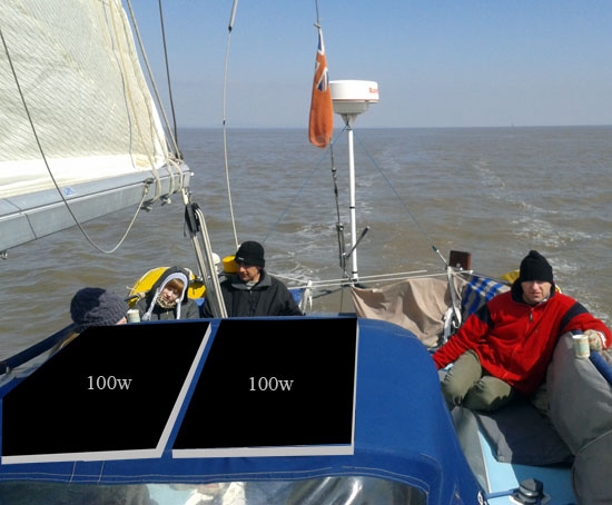

I'm planning to install my two 100 w panels on top of my spray hood similar to the photo below.
Our spray hood remains up pretty much all the time.
Running wires will be a lot easier in this position on our boat, and given our frequent trips to Holland where we visit lots of locks and tight mooring boxes I don't fancy their chances on the guard rail.
