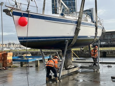

Stargazer was lifted, at Chatham, on Friday. Pleased with the effectiveness of the Seajet Shogun 033 (as I have been since switching from Tiger Xtra, 3 or 4 seasons back). Just slime. Heaviest at the waterline - although a 'beard' only really developed once we 'parked up,' in autumn. Worse on the south facing side (when on her home berth) shown here.
She had 2 coats of 033, before launch at Easter 2024. Sailed for Biscay in April. Returned in October. Then sat on her berth, until Friday's lift.
