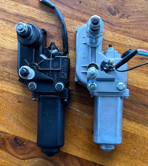

After much searching I found a replacement motor for the Doga! The one on the right I got from China via Amazon. There is one down side that the Shaft is much longer and they don't do a shorter one.
I am going to get another and see if I can transplant it into the Doga shell.

here is the link to the motor I bought (fitted and working) https://www.amazon.co.uk/dp/B0F662W15J?ref=ppx_yo2ov_dt_b_fed_asin_titleWould you post the link to the one you bought, please.
That looks similar to the Roca. I 3D printed a mock of that motor and could not make it fit in the space, the shaft is on the wrong side, I did not really want to make new holes and patch the old unless there was no other option.I thought you already had a plan......

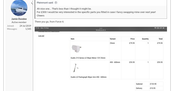

Try this Exalto wiper motor or search the MBW forum for "pantograph"I need to act faster when someone gives me useful advice! I totally forgot about that helpful post from Jamie a couple years back
Plus those motors are now £125! Dammit.
Thanks Plum
PS - just tried looking for that thread but can't find it... Have you got the link please?
Nice one! Many thanks... Just had a read... I remember the blown fuse/controller saga now!Try this Exalto wiper motor or search the MBW forum for "pantograph"
