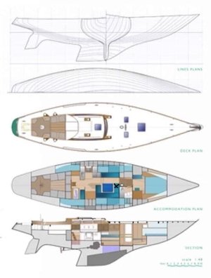

X marks the spot where I want to put a drip feed stove, which is highly likely to be a Refleks, as they have all the features that I like (ability to run radiators, hot plate, and best of all a balanced flue system with an air intake in with the exhaust flue, which solves the recurring pressure differential issues, which can make life a misery when running one of these stoves at sea.
X is currently a settee over an empty battery box. Unlike the previous owner I don’t need to accommodate a crew of a dozen - we’ve never sailed more than six up.
There used to be an Eberspacher under the skipper’s bunk and since the plumbing ducting and wiring is all still there she will be getting a 4kw Espar in its place.
