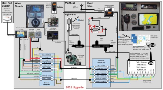

Navionics .... it just works. I used a cheap tablet case to hold the tablet, cut the front flap off, strengthened the back and drilled 4 countersunk holes in it. I screwed the case over the hole left by my obsolete and ancient ex-chart plotter and the tablet could be simply clipped in and out or used in-situ.
The tablet was connected to the boats NMEA2000 network with a wifi gateway and navionics could use my real boat data, displayed AIS, depth, speed through the water ... not much to setup either. Could also use the tablet to display instruments and other boat data like my Victron components.
Looked like this ....
