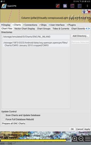

I have often had difficulty getting recognition of chart files in the directory .
In this case I copied the exact directory entry from my PC where it works happily on OPEN CPN.
I recall that the address must include the last folder that contains the charts.Screenshot_20250106-165320_OpenCPN.jpg
