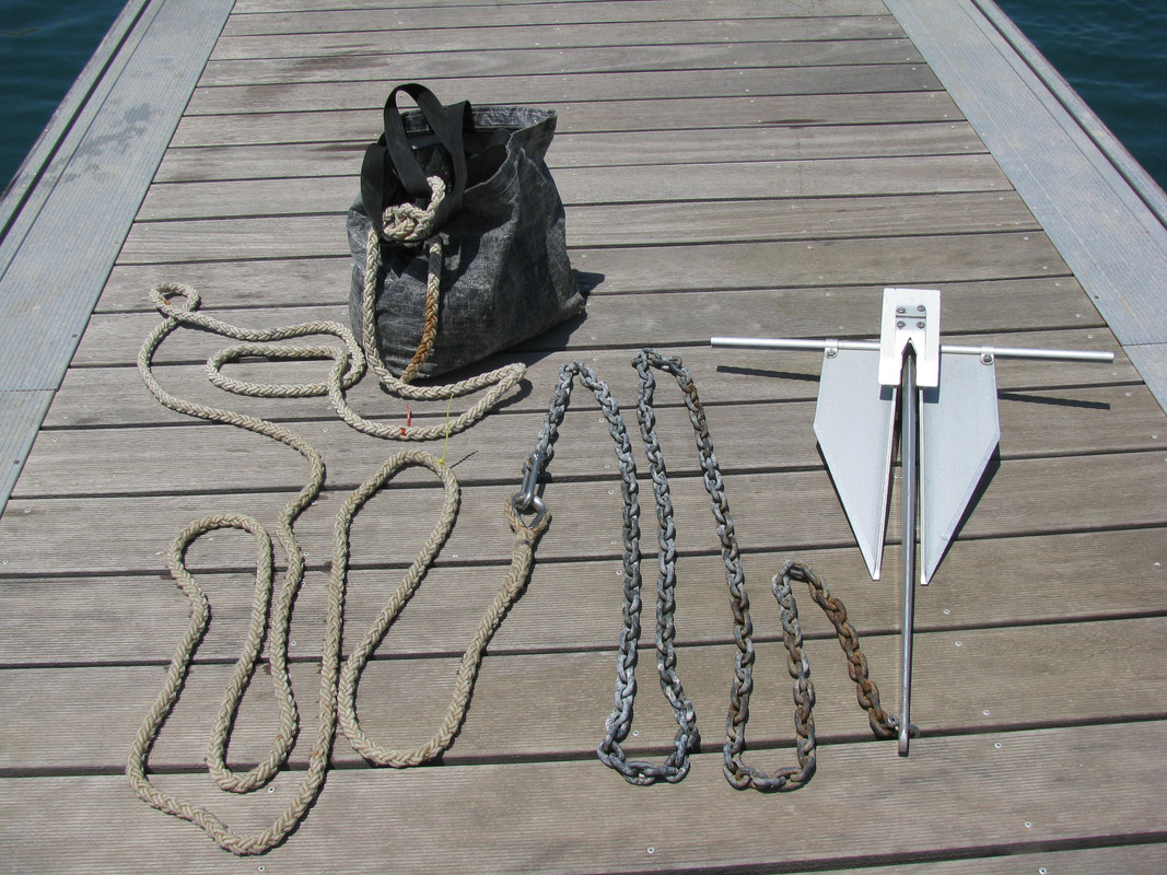

This photo shows my kedge anchor, Fortress FX16, 5 metres of 8 mm chain shackled to 55 metres of 16 mm Anchorplait. I have owned this combination for many years and have anchored on it, mostly as a kedge or in a fork mooring, hundreds of times. In addition I have anchored on it alone several times for a variety of reasons. A couple of years ago I sat out a full gale for 2-3 days on it, due to confusion about the length markers it turned out that the scope was only 3:1 in about 5 metres of water.
It was shackled together so that I could use the Anchorplait as a tow rope or warp if necessary. The shackle has never given any trouble. The diameter of Anchorplait was selected for handling, rather than strength. This has paid dividends when retrieving the anchor in the dinghy.
My boat is a Sadler 34.

Bit of rust near the join of the anchor though. ;):mad:
