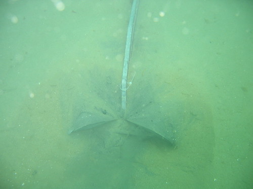

If I do swim from the boat, I'm always intrigued to see how the anchor is lying. This photo was taken in swanage in about 3 metres of water. Its sandy, but despite that, we've never dragged there even though it looks like the anchor isn't doing anything:
Rick
Rick
[/ QUOTE ]
You have me intrigued now Rick, in the morning is there a circular track dug as the tide has turned ?
I know the sea weed is cleared for 20 m circle but your photo shows a little track as the anchor has set.

That photo was taken shortly after we anchored, so the track was as we pulled back on the anchor. As to whether the anchor turns with the change of tide - I've not really noticed to be honest. I suspect that in places like Swanage (not much tide and we usually only anchor there in calm conditions) then I suspect the anchor doesn't move and its just the chain holding us.
I'll try and get 'before' and 'after' photos sometime.
