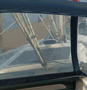

Can't advise on the alternator as I have a VCR and 3*95ah LA house batteries on my 331, max I have seen it put out is 45A. But I have a Photonics Universe 80AH semiflex panel which fits neatly on the hatch garage and keeps batteries well topped up via a Victron smart MPPT. I intend to get a large portable panel for when several days at anchor.

I am definitely leaning towards using the hatch garage for mounting my solar as well. I realise that this location is not optimal because of boom shade, but it is space that is otherwise going unused and any benefit I can get for the cost of a panel feels worth it. It is good to hear that your 80w panel is enough to keep your batteries topped up while you are away.

Realised it is the 60W I have, but this works OK even brings batts up a bit. Boom shading is an issue but these ones have two parallel circuits of cells which helps. The 80W would just fit (I think) but come right to edge of the garage and could get trodden on. A bigger panel could be fitted by rebuilding the air vent but I think a portable panel strategically positioned when at (occasional anchor) is my way forward. BTW, we managed five consecutive nights off grid this summer with just two days having to top up with engine.

Two strings, connected in series with bypass diodes. It won't help as your panel voltage is 9V when one side is in bypass, which is too low to charge your battery. You'd need another panel in series to make this effective since then it could hit 27V with one string shaded or 18V with two shaded in any combination.
I suspect in reality your panel is shaded a lot less that you imagine. Ours are across the coachroof so in theory all 4 strings on the two panels are shaded by the boom but almost never are.
?? from his photo, he has 18 cells in the panel I suspect, only suspect as I have no real knowledge of the panel, that there are two sets of 9 series connected cells connected in parallel. Could be wrong, not unknown. 😵‍💫 :ROFLMAO:
It's a pretty standard setup these days and common to all panels with two bypass diodes. There are two strings of cells, each with a bypass diode. All cells are in series, but each half can be bypassed if shaded.
It's too complex/expensive to add a bypass for each cell, but that would in theory be better.
Sorry gents, but you are both mistaken.
That particular panel is made up of 36 half cells. 18 half cells in each string, the two strings then connected in parallel.
Each half cell is 0.5V ( or thereabouts), so each string is 18V (or thereabouts). The 2 strings in parallel are then obviously 18V. If part of one string is in shadow you still get 18V from the other string, but a reduction in voltage and current from the string in shadow.
Shading has a greater effect than might be expected, even with this type of panel. You only need to cover a small area of panel and the voltage loss can render that string virtually useless.
What's half a cell between friends. :ROFLMAO:
Becomes clear when looking at the PU website picture rather than the photo.
