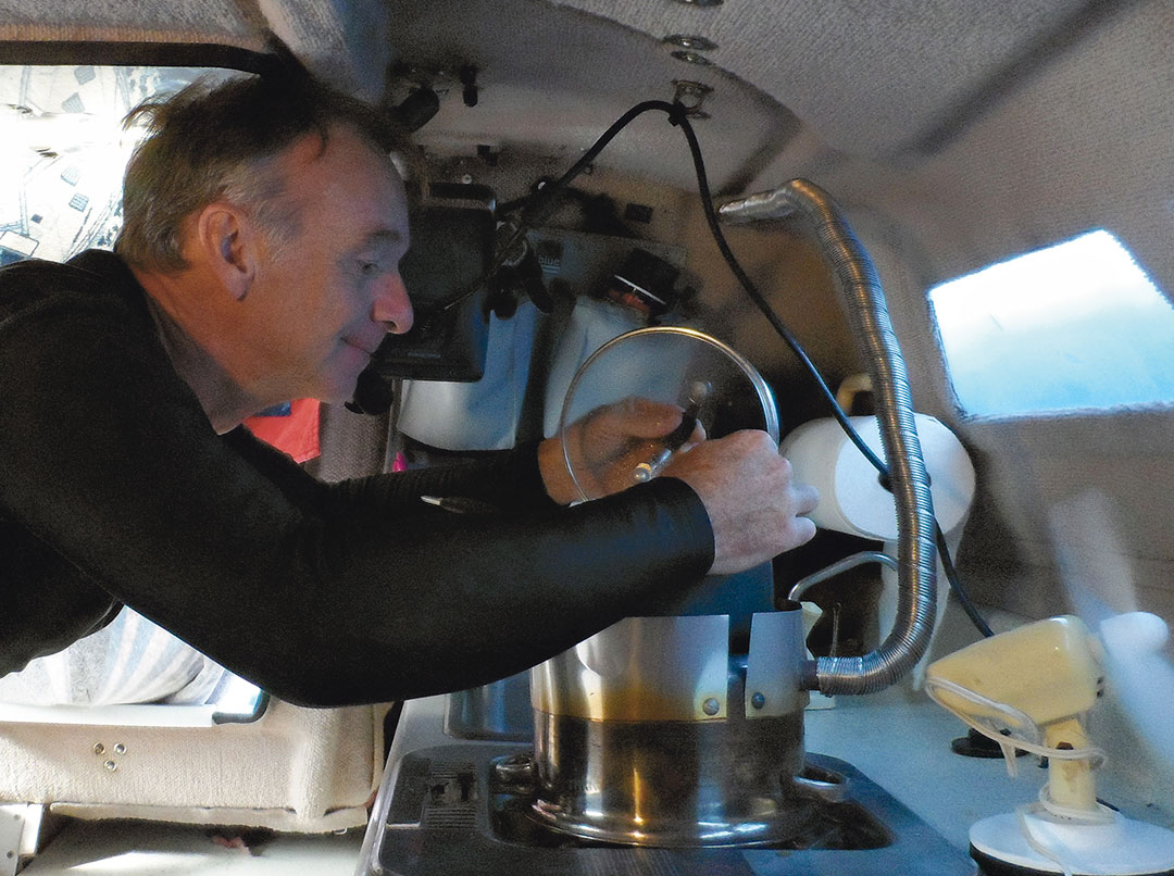

I find the Idea of running a non-vented heat both dangerous and unhealthy. High CO2. Possibly high CO. Certainly a headache. Finally, the heat output is the same as just running a burner; the top converts some heat to IR, but the BTUs are fixed. If it is actually cold, the required ventilation just chills the boa back down, and the moisture in the cabin from burning C2H6O makes it a clammy heat rather than a dry heat.
Instead, build a real stove top heater that is vented. I use this one on my F-24 trimaran. Dry heat, no exhaust in the cabin.
DIY Vented Stove Top Heater. Yes, that's me.
