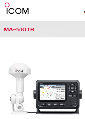

Thanks for all the replies. I've just bought at the Boat Show an ICOM MA-510TR Class B AIS Transponder with a SP24E external speaker. So should be even louder than Baggy's.
