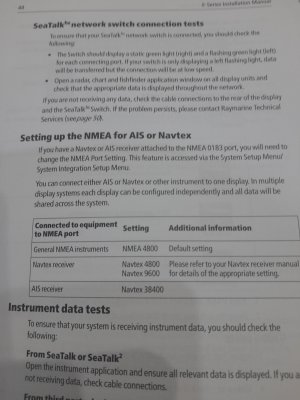

Hi guys a silly question , is it easy to link the ais to a raymarine e series 120 , well I have the 120 in the cockpit and a smaller one on the upper helm all linked by sea talk 2008 now I believe it has a NMEA 0183 connection , I only want to display on the upper helm can these work together , I am lost. Thanks for any help.

The Emtrak has NMEA 0183 and N2K, easy to connect.
Which E series do you have, Classic or E120W ?
The Classic can only be connected by NMEA 0183, connect the two HI OUT wires on the Emtrak to the to IN wires on the plotter (green - , white +)
