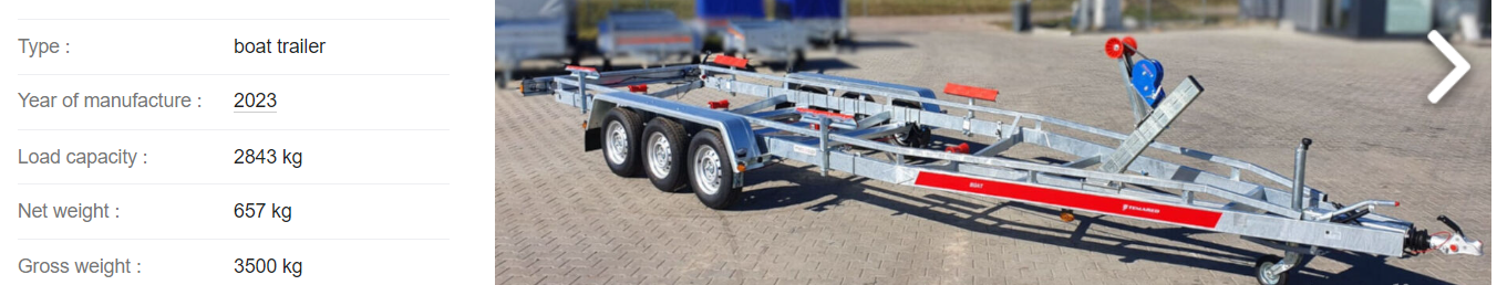

In addition to all aspects of trailer legality, size and weight will have an impact on handling during launch and recovery. In anything but calm conditions, waves and wind will be a challenge and a few tonnes is a lot to handle by hand.
You'll need at least a two axled trailer but boat length also needs to be considered (I think the maximum total weight on one axle is about 1800kg).
The boat should sit perfectly on the trailer every time and be secured with straps so that it and the trailer form a self-supporting unit - this, together with the correct load on the towbar, makes for much better handling.
The height of the boat on the trailer needs to suit your shed (and bridges you're going under), and it's a fact that the actual competency of the vehicle in this marriage is more important than being legal - just. Being approved to hook up is not the same as being capable on roads and ramps!
On a gravel or slippery ramp you will need 4x4 and with the overall weight and resistance, you should expect a frightening fuel consumption when towing. And when not.

1/Big but towable @ 3.5ton . about 2.7t of boat + 750kg for the trailer
