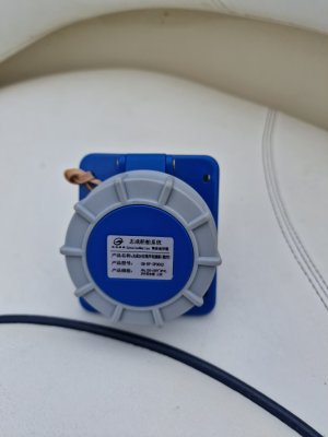

I have a socket to add to the boat which would allow me to bring mains power aboard.
In our caravan we connect to mains which powers the 230v sockets and charges the batteries.
Not fussed about sockets, although would be convenient to have 1 in the cuddy, but being able to charge batteries would be really helpful.
This is the socket I have...

You need to look into this properly, if you only have the socket and not the RCD circuit breaker it is not easy.
If you look at camping suppliers for a mains lead complete with safety devices.

Shouldn't you be using a mounted plug (male), the socket (female) should be on the end of the cable.
If you mount a socket, then you'll have the live pins of the plug exposed.

The easy way is an extension lead with a few 13amp sockets, but they're a pain. You'd be relying on the RCD in the marina supply, but it's far more likely to kill you by tripping you up than electrocuting you.
The proper way is that inlet - I hope it's an inlet with pins, because that's what you need, so the outlet on the end of your lead has holes, keeping the shocking stuff away from wayward fingers - feeding a box with an RCD and two circuit breakers, one for the battery charger, one for 13 amp sockets. Use flexible 2.5mm wire, not domestic cable. If that makes sense to you, you may know enough to do it safely. If not, get someone who does to "help" you (they do it, you pass the tools and make tea). Leccy in a damp environment can be nasty stuff
Always fit more sockets in more places than you think you'll need. Sockets and wire are cheap, not having enough or in the right places is a nuisance long after you've forgotten the few quid you saved.

One of these campsite hook up leads might be suitable for occasional use. They incorporate an mcb for overload protection and an RCD for protection from electrocution.
For a more permanent installation a "garage consumer unit" may be used, They incorporate an rcd and usually two mcbs , ! x 6 amps and 1x 16 amps. The 16 amp mcb can supply a small number of sockets and the 6 amp one can be used for a battery charger.
Agreed, looks like an outlet socket, not an inlet plug.

Get one of the camping style extension lead which is complete with rcd and 3 sockets. I mounted mine inside with an external socket in the cockpit(as you show). Then you'll need a lead from the marina socket to your socket. Caravan & camping shops are usually cheaper than Marine shops!
Use the one that VicS posted complete with lead. Ideal for your situation, as I read it, and less hassle and confusion!
