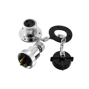

Yeah, our Ocean 37 has 24V sockets dotted about, only thing is that they are the same sockets as the mains sockets here, at least they are labelled as 24V, and there is a 12V socket as well as 24V and 230V sockets at the chart table
Outside the plugs and sockets are like this in 2 pin for 12V and 3 pin for the 24V:
