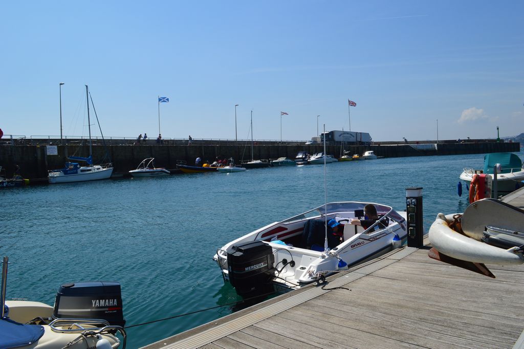

Well, finally got some proper testing in for our 'new to us' Fletcher Arrowsport. I had intended to do this before the Fletcher rally, but due to a mix or weather, illness and work, the rally became the shakedown! Unfortunately a number of issues scuppered her run on the rally, but we did manage to do some testing and identify three issues. The first was water in the fuel - this became obvious on the slipway and had clearly been lurking behind baffles in the tank. I had pumped out the tank via the bulb, but there was clearly still more in there and I'd topped up with another 50L! Issue 2 was after having switched to the spare (portable) tank, we headed out to follow the group in 1M+ seas, but lost drive short of Berry Head and had to be towed in! :-( Back on the pontoon, we found this to be prop bushing failure and an impromptu run home and a prop-swap fixed this one too. Joining the twilight cruise, the sea was much better with perhaps 0.5M swell, so first chance to open her up. Third issue was less easily fixed - serious intermittent over-voltage - peaking around 18.5V!!! Thus she was retired from the rally before the electronic fried - or worse caught fire...
Since the rally, I have removed and cleaned the metal tank, fitted a new regulator and a water separator. I have also bought a 53L tank to fit as the metal tank has significant pitting, but layout of filler means cutting a new filler neck and I've yet to source a 50mm hose tail bulkhead fitting!
I've just put her on the visitors pontoon for a week and will look to test a bit further over the next week. We went out for a pootle around first and tried some faster runs, but have already determined that we need to work on the balance a bit. She's almost impossible to get on the plane with anyone sat in the back and even with Cheryl & I up front and Edward sat on Cheryl's lap, she struggles... She will go if pushed then however and when the motor hits around 4500rpm the bow drops and rapid acceleration to high 30's follows in short succession - albeit with severe porpoising! I do have the anchor and an extra battery in the stern, but I think the 60L tank is much of the issue. A friend had an Arrowflash (15') and that had similar traits.
I have a pair of smart tabs that I think is the next thing to try (along with moving the spare battery and anchor into ski-locker), but ultimately I think adding the 53L plastic tank to the ski-locker with a new deck filler is the answer along with removal of the metal (stern) tank.
Would appreciate any thoughts from the panel in respect of moving the tank - is this likely to make it bow heavy? (I can trim out to create more bow lift, but can't trim in any more to create less... :D

Have you got the engine trimmed all the way in when setting off ?
Fletchers dont feel like you are discribing, there is something wrong. You wont need a drum of water. Ours ran easily with 6 or 7 adults and kids on board, anchor and chain,battery and 2 portable tanks under stern and lots of skis in the bow. I know that yours is a newer model and the deck has more substance to it than ours did, but even so it can only be 40 or 50 kg heavier.
A quick run through on the Mercury Prop Calculator (with some guessing of figures) suggests a bigger pitch prop is needed, 13 x 21 to 13 x 24.
Fletchers dont feel like you are discribing, there is something wrong. You wont need a drum of water. Ours ran easily with 6 or 7 adults and kids on board, anchor and chain,battery and 2 portable tanks under stern and lots of skisin the bow. I know that yours is a newer model and the deck has more substance to it than ours did, but even so it can only be 40 or 50 kg heavier.
A quick run through on the merdury Prop Calculator (with some guessing of figures) suggests a bigger pitch prop is needed, 13 x 21 to 13 x 24.
Thanks again Mark - yes trimmed right in. I've been making a list of weight from memory: The tank is metal and weighs perhaps 8-10kg? I think it's 60L. There are currently 2 batteries (one each side - the 2nd not connected). Then there's a 4L can of oil, by tank, spare prop, ski pole, flag pole and a few lighter odds and ends under the rear seat. The anchor is perhaps 10kg with about 6M chain (8mm?) There's various 'stuff' in the side pockets like flares, throw line, hydraulic oil, ropes etc and paddles, jump leads and more ropes etc under the floor. There isn't much up front - and I think that's the issue, i.e. not so much too much weight, but where it is. I'll remove the extra battery during the week and move the anchor and oil to the forward ski locker. Then take her for blast around the Bay before refilling the tank (we've used about 20-25L I'd estimate). She'll hopefully handle better and we'll know we're on the right track! I do have a 21p stainless prop from eBay, but want to get a benchmark before I try it.

I agree with Landlockedpirate; you shouldn't need to ballast your Arrowsport if it is set-up correctly. I have an Arrowflyte with a 75 Merc, a friend has a 155 Arrowsport (albeit the previous model to yours) with a 90 Merc and a neighbour years ago had a 155 with a 70 Merc. These are all basically the same engine as yours. Both Arrowsports feel/felt far more 'planted' than my Arrowflyte which turns quicker but feels more twitchy at speed.
My friend and I both add ballast in the bows of our boats but only because we are pulling fat old men on deep-water mono-ski starts! When we are just out for a blast we don't bother.
<Teaching Grandma to suck eggs>
How high is your engine? The anti-ventilation plate should be roughly level with the pad when trimmed level.
Where is the engine on the transom? Mine is offset about an inch to starboard. Some people fit them centrally. If yours is offset to port that would be bad.
Are all the engine bolts fitted and tight? The nuts are usually brass and I have seen them stripped and the engine moving around.
Is there any slack in the steering gear? This can cause some bizarre handling characteristics.
Is the lower trim stop bar still fitted? Most workshops remove this when fitting this engine to small sport boats like yours. It allows the engine to get that important last bit of trim-in for better acceleration.
The prop pitch is good but is it the correct diameter? I think it's meant to be something like 13.25". 38 knots/45mph should be bang on for an Arrowsport with that engine/prop combo.

Thanks for the feedback and thoughts. Would agree that it shouldn't need ballast, but can't get away from the weight at the stern. I'll address each point in turn below:
I have the opposite which is why I've concluded the balance is off somewhere :)
How high is your engine?The anti-ventilation plate should be roughly level with the pad when trimmed level.
Factory fit I believe and yes, ideal alignment.[/QUOTE]Factory fit I believe and yes, ideal alignment. AFAIK.
Agreed and slightly to starboard I think - will measure how much tomorrow when I go down - Arrowflyte was 1.5".
Yes - checked there's no movement.
I didn't feel any and did check the steering as it had new cable fitted 12 months ago by previous owner (had been laid up since with only one outing). Steering feels responsive enough but not enough hull in the water I think when she does get on the plane to get stability and hasn't yet been flat enough for sustained run/play with trim. (too busy keeping in straight line/getting thrown about and trying not to scare nipper witless! :rolleyes:)
Interesting point and Yes - still fitted! (perhaps worth removal to facilitate 'trim in'...)
Yes - 13.25" 3 blade ali @ 19p
Is there water trapped in the boat?
Possible, but hadn't been used bar once for 12-18 months and not in last 12. I've had approx 8 weeks and she's been parked on a slope with drain out and both covers fitted. She was dry inside when I collected and I think had been stored inside. There could of course be water absorbed into buoyancy foam or caught behind stringers if cells have been compromised, but floor appears solid and wood where exposed (e.g. edge of ski locker in floor etc) is dry and rot-free.
I went down with a friend today and he concluded that she does sit a little stern heavy - for example, the seawater slops through the drain holes of the splash-well and if I sit on the stern the slightest wash will lap over the transom. At rest with nobody aboard, the transom is perhaps 2" above waterline max. (Wouldn't expect much more with the 90 on the back perhaps)
Going to try moving some weight during the week...
