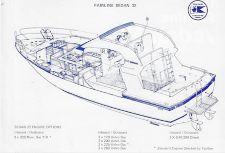

When looking at #23 you notice that out of four offered Volvo engines only one was a Volvo - the rest (including the standard 2x225 hp fitment) were GM's.

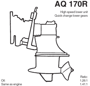

There were also details of the Aq170 to racing spec including waterpiercing /streamlined drive
Would be the "R" version
Model HP Cyl From to year
BB 170 A 170 6 1969 1972
BB 170 B 170 6 1972 1973
BB 170 C 141 6 1973 1978
AQ 170A 170 6 1969 1972
AQ 170B 170 6 1972 1973
AQ 170C 160 6 1973 1978
AQ 170D 160 4 1978 1980
AQ 170R 200 6 1970 1975
