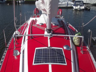

I bought an 80W solar panel, that is flexible to a limited degree ... its to replace the panel on my 38 and needs to fit the slightly curved deck.

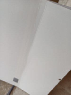

When walking away from Courier van back to house - I noted that the package had a slight curve to it ... and slight damage along edges...

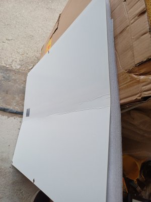

I open the box and the panel has a crease in the back with a definite curve to the panel ....
There is no sign of damage to the cells on other side - just the bend ...
I put a meter on the cable with panel propped against the wall .... 100% cloud cover - so no clear sun ... and meter read 15.8V ...
Not sure what to do - as it appears that even if dead straight / flat - bending to suit deck will likely cause similar ...
Do I contact seller or try it considering it does show 15.8V in a dismal total cloud cover day ?

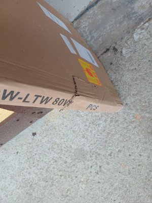

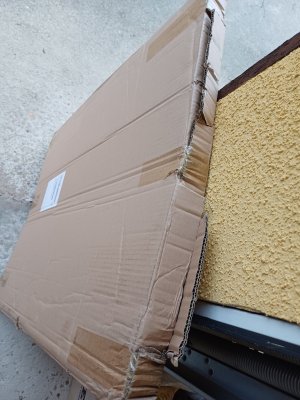

You must return it. It could suffer premature failure. I recently ordered and received replacement 2 x 80W panels and the retailers warned me to check them for damage after receipt. I found each box had been prenetrated by a mechanical claw. I returned them and the retailer has supplied two new ones.

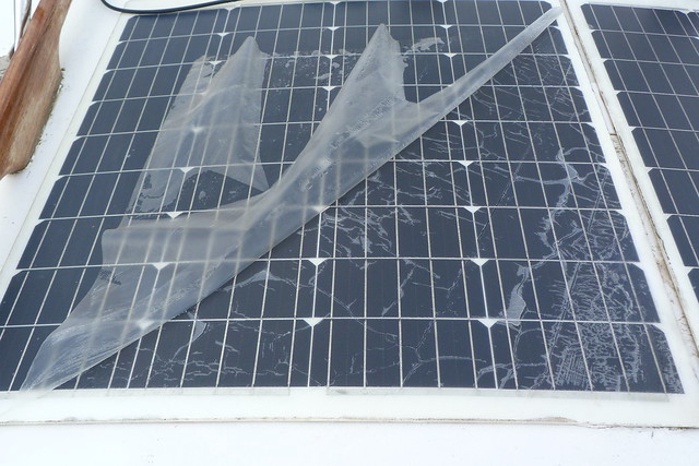

When I bought originally, the panels had a one year warranty. Now it is 3 years. It is still new technology. I asked Gorilla if they could recommend a clear glue to re-fix the EFTE laminate and after referral to their back-room chaps, said 'there was nothing they could recommend'.

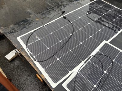

P1100246 by Roger Gaspar, on Flickr
The damaged panel is still working fully - at the moment. The one to the right is 'undamaged' but fails intermittently. Note the delaminated panel has two distinct lines diagonally. I think when the theft occurred on one night 4 years ago, I think the life raft (in case) was dragged over it and that might have prompted the delamination.

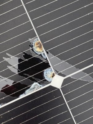

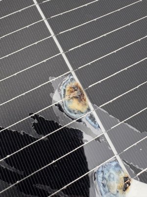

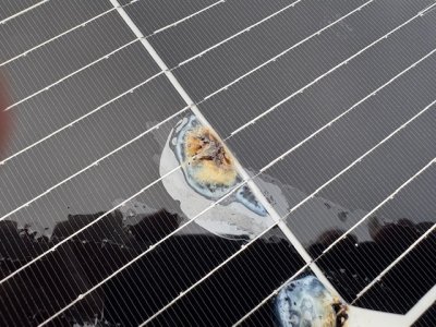

Just be careful of using a damaged flexi panel. They've been known to go on fire when they start to arc. I've heard of it happening with panels mounted on top of biminis. Sunbrella is really quite flammable...

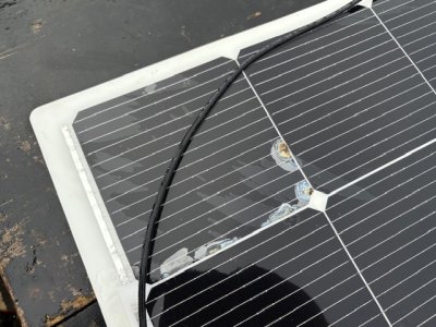

Some truly awful panels courtesy of CraigSolar
Lasted about 2 months before this happened
Lucky it didn’t burn the boat

I have a suspicion that flexibility is only supposed to be in longitudinal - not transverse .. which this panel has been subjected to.
