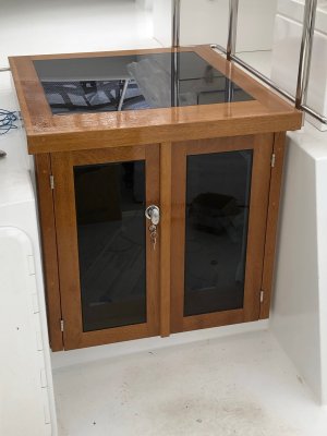

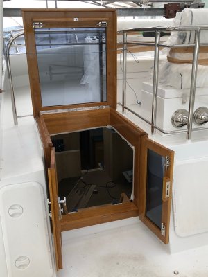

I had success with rebating some 8mm tinted acrylic sheet on my router table. As has been said, reduce router speed by about half and ensure that you have sharp/new cutter. My need was to achieve a flush finish on the doors and hatch lid on my cabin entry. The acrylic sheet was rebated so that it fitted into a machined groove in the frames.
View attachment 171352View attachment 171353
Very nice, way above what I'm doing!!
