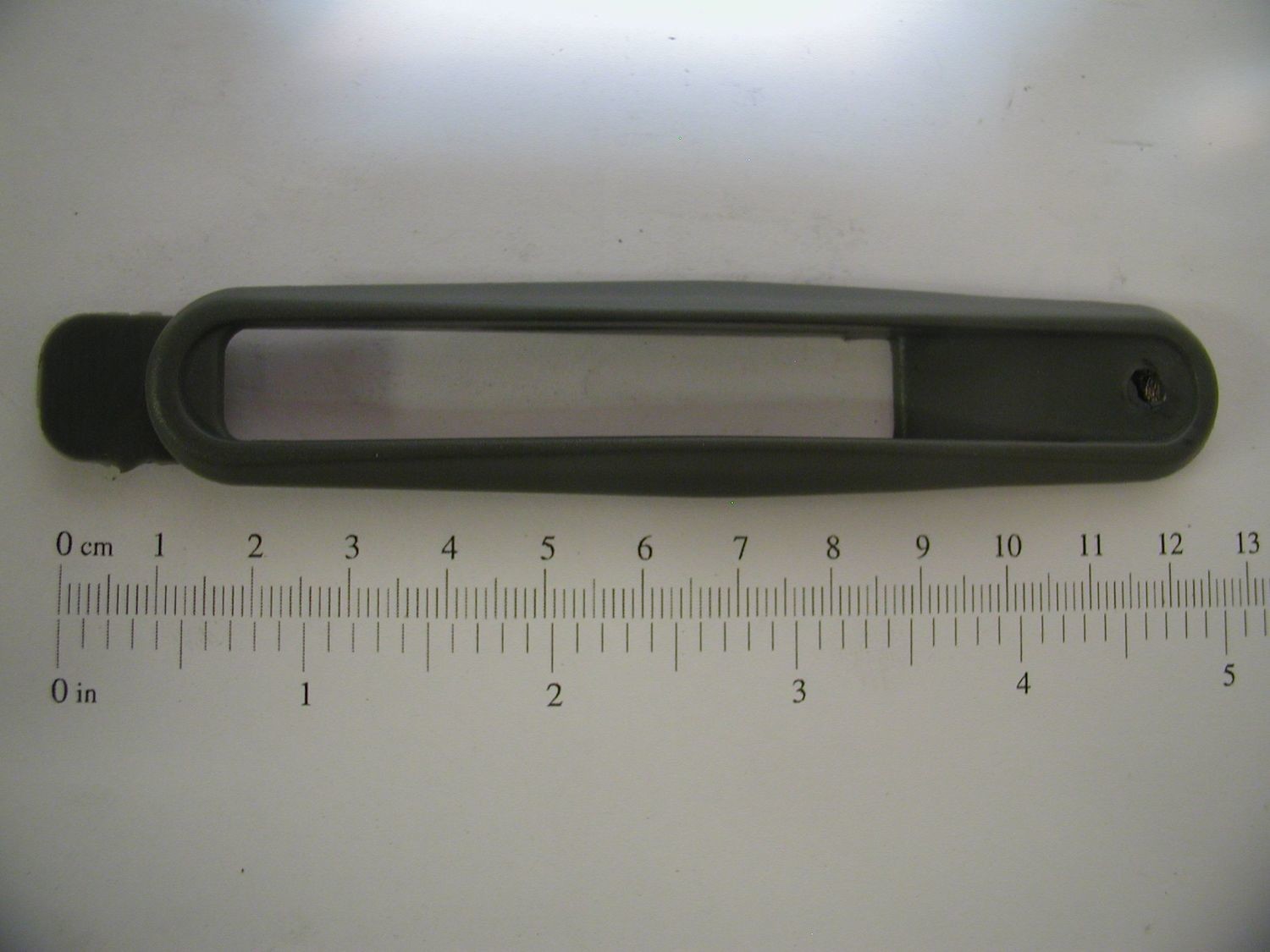

I have just purchased the chaff reducers (probably not the right word) that fit into the mast to stop the lines getting chaffed that run inside the mast. Has anyone 3d printed those? Mine are from Z spars. They are plastic and held on by 1 rivet

cannot find on Z Spars site .. do you have a link to them ??
This ?
Problem here is to use a material tyhat can resist the chafe of rope on it. Most items like this are Glass Filled Nylon .. (GFN ... GRN) ... to give the strength and resiliance.
PETG would probably be ok but not as long lasting.
