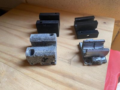

V band clamping ringI've just made one of these - can anyone guess what it is?
Looks like a clamping ring for a Jabsco diaphragm pumpI've just made one of these - can anyone guess what it is?

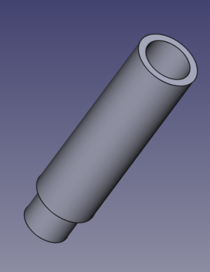

This is a screen dump from FreeCAD
Printing was a little more complicated though (orientation and supports etc) but I have a result that is as strong as the original - made from ABS.

Nearly correctLooks like a clamping ring for a Jabsco diaphragm pump
Great work on FreeCad! I had a clamp ring break earlier in the year and I did consider trying to print one, but I felt that the layer lines introduce too much weakness., and didn't fancy the risk with the black tank pump!Nearly correct
It is the clamping ring for a Whale Gulper Pump.
My original ones broke so I bought a replacement and a spare sets.
I still have the spare set but I thought it would be in interesting challenge to see if I could make a replacement.

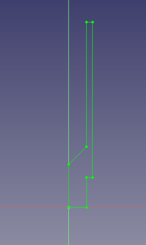

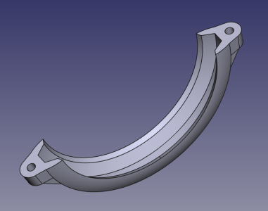

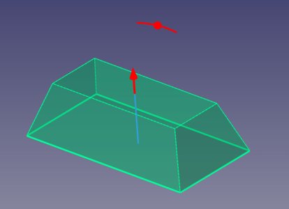

I'm actually quite pleased with the FreeCAD design - 2 profiles extruded round 2 paths and some mirroring.
I'm really loving working with FreeCAD - it takes some work to understand it, but very rewarding results.

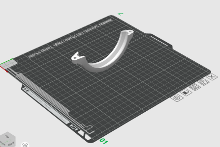

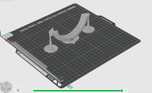

As said above, the print orientation and supports were a bit more complicated than usual
This is the orientation on the build plate that I chose
And these were the supports that I selected
This print orientation kept it strong and the inner surfaces as smooth as the original manufacturers one.
