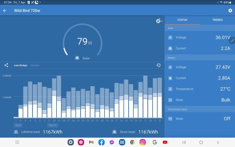

This is my only data logging. A snapshot at 0700 in the morning

so guys, what charge settings are you using? I'm 100% on solar & have been terminating bulk at 13.8v then 'float which isn't really float' 13.37v
Smartshunt doesn't get reset so reckon it's drifted SOC loads, too lazy to retype so details are here >
What do you think SOC is charging to 3.45v
SOOOOOOOO happy with these things, lifechanger living onboard. 😎
We are using 28v, so 3.5v/cell and the same float as you. Absorbtion is 30 minutes.
We only get to 28v about once per week. We just make more water or more hot water and keep the battery condition lower. When we do get to 28v, the battery balance is doing very little. The 280Ah CATL cells are very good
