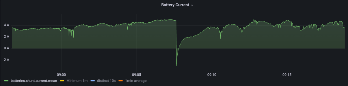

I've 2 x T105's and 300Ah Lifepo4 connected to a 12both switch. Very wary the first time... but now just switch between them going through both, or leave at both sometimes. Trojans on a smartguage to make sure they're always charged or nearly, lithium monitored using smartshunt data for now. They´ve been sharing solar to get the trojans up to full charge today so voltages are the same, just disconected but in the morning I'll connect to both and post the current. Smartgauge sends once a second so might miss the worst of the current but the invertor can pull hundreds of amps so really not worried. Very handy having 2 banks so if you want to work on one you don't have to turn everything off.
Once the system evolves i don´t think the trojans will get used much if at all but I won't float, just give a little freshing charge once a week or so.
Haven't researched but fairly confident sitting on float all the time would be worse than sitting disconnected at full charge .
Me & my windlasss both love lifepo4 😊 total game changer. Much more relaxed about power on the boat now.

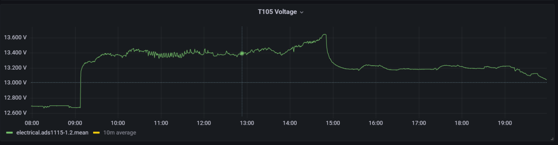

edit: SO here's the trojans today, connected to LFP this morning & just disconnected, solar regs went to float at about 2:30.
Very little current getting logged when they were join, though trojans were 80/90% charged. Pity smartguages don't work on LFP.

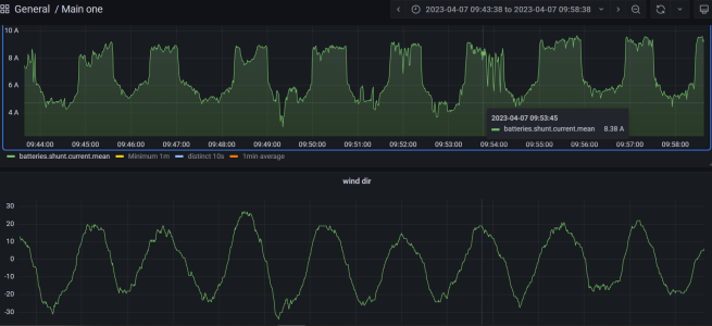

If you don't log & look at the data you're mostly seeing what our biases decide on a blurred snapshot of an image instead of front row Imax watching ultra slow motion.
The data don't lie 😂

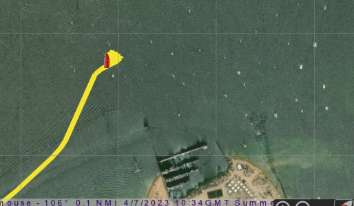

edit, slight drift but patterns like this are invisible without logging - apparant wind and current into the batts 😎
GHA
26 Jun 2013
12,427
Hopefully somewhere warm
wtf are you doing GHA? spinning around on anchor?
recon you should reposition your panels 😁
look at the apparent wind on the lower plot, boat is tacking side to side quite slowly & quite uniformly in 20Kts. Never knew this until today plotting the data . 😎
Position is pretty stable.
(Where am i 😉)
geem
27 Apr 2006
8,043
Caribbean
(Where am i 😉)

You need a riding sail. Friends with a Jeanneau 45 installed one this season. What a difference. They would veer around the anchorage like crazy. Now they don't move.
Played with riding sail for a while, before it got all intimate with the windgen in 40Kts 🤯, heavy long keel so less than 40kts odd really doesn´t need one. Boat doesn't veer around like the modern light plastic, just tacks gently unless it's an 8 or so.
Point is without plotting data there's no way anyone would know it´s such a perfect oscillation at lower wind speeds. Well over a decade and a half onboard I've always been aware of the shadows moving but never suspected it was such a beautiful regular cyclic movement. ❤
Don't plot the data, what you think is the real world is mostly bias & guessing. My experience anyway, the cold chisel of data piercing through so many preconceived ideas. 😎
Good practice imho, admiting you're completely wrong and know much ess than you thought 😂
