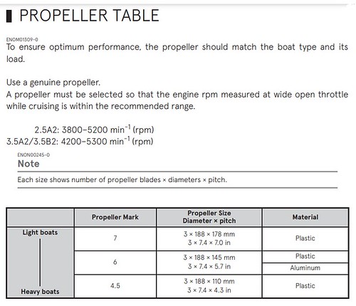

I can't blame Munster1967 for wondering about this, it's a foggy area to me, too. The fact that there are tiny and not-so-tiny outboards makes one hope that using the bigger one will inject some fun rather than just being better than rowing.
I was told by the engineers at Fairweather that my 3.5 two-stroke hadn't been revving properly when I took it in for servicing. I hadn't realised, I simply hadn't known how much grunt it ought to deliver. I hope I'm going to enjoy finding out, now it's fixed.
But looking at Tohatsu's propeller table (below) for their 3.5hp and 2.5hp two-strokes, and the similarity in their rev ranges, I wonder what sort and weight of hull (which might be considered suitable for such a small o/b) would actually reflect the extra power of the bigger motor, with higher speeds?
It sounds as if it's a case of less always being more. :cautious:
Thank you. For understanding my enquiry. 🙂
