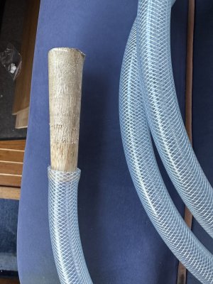

I just replaced some of the hoses on my old Princess. All the hoses are 3/4’’, and the thru hulls seems to be 1’’. I changed to a softer hose, used a wooden conical plug a hammer a bit of soap and some heat. I was not easy but after a couple tries it worked. I did not use to much heat, and waited for the hose to cool down before installing.
