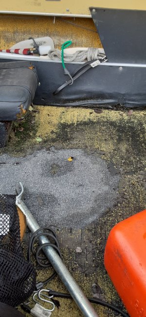

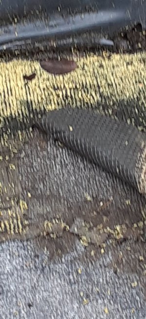

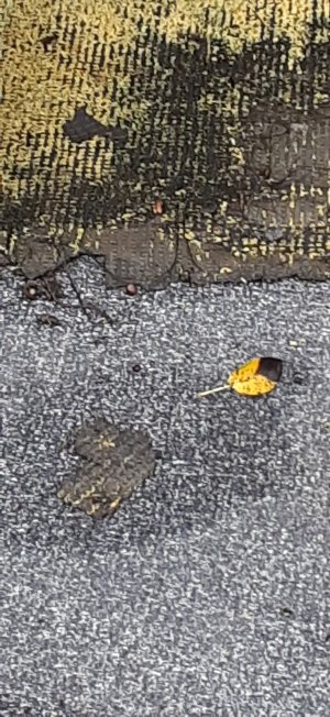

@kashurst the carpet is not glued down, just lying loose on the floor
here are some pics I just shot of the mess -- sorry for the bad focus I have a dumb phone and it sometimes takes dumb pictures

That looks like someone has put carpet on top of marine carpet. 40+ years later it's all a bit knackered.
As I said before you won't damage the boat with a bit of scraping back. Boats are generally very very strong. Much stronger and more heavily built than cars or caravans. I can appreciate your father's caution. but don't worry, you won't break it. The black side panels are just marine plywood with vinyl glued on. Nothing you can't get on Ebay or amazon for not a lot. The seats have worn through a bit, but again, Ebay and Youtube etc are your friends.
