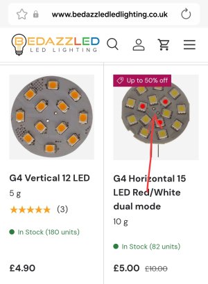

And I know this question wasn't about suppliers.. but I bought all of mine from Bedazzled over 12 years ago and have not had one go wrong..
The reason I chose them was they seemed to be the only place saying that their LED bulbs were protected/fused...
and of course the fact they work from 10v-30v..
and the best thing was their red/white G4 ones... Switch on once and they come on red. Switch off and then on again and they end up white. All my bulbs are now this red/white (which saves any dazzled eyes at night).
G4
and the final feature discovered in the G4 discs was that if you have a round light fitting that they only just fit into, you can de-solder the two prongs and solder wires (flying leads) into the two central holes from behind instead..
