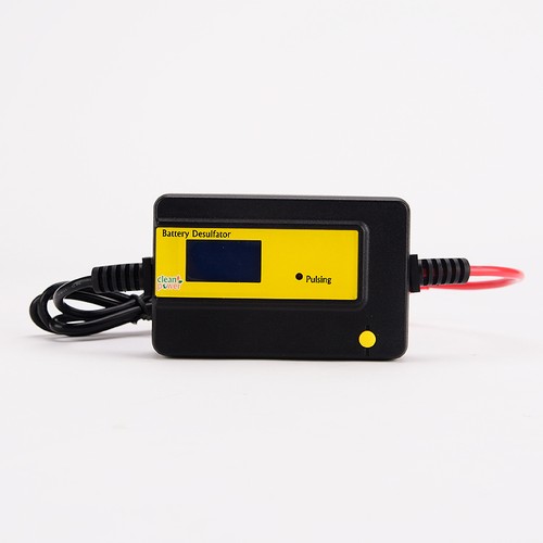

OK ... om another Forum - a trusted member has tried out a few 'De-Sulphators' and they reckoned they had good results from one unit .... (they have no commercial of monetary interest in the product).
www.ebay.com/itm/Auto-Pulse-Golf-Car-Battery-Desulfator-Lead-Acid-12V-to-72V-AGM-GEL-400AH/153302998489?hash=item23b1921dd9:g:JGMAAOSwY3BZN7ZK
So for the price - thought why not .... could be worth a try ... I have a whole bench load of crap batterys .....
At present its pulsing away on one of my Lawn Tractor batterys that's 'lazy' .......
I'm not a believer in these things normally ... but "Chellie" who recc'd it on an RC forum - says she's sorted out a couple of batterys with it ... and she has no connection whatsoever with the unit other than as a buyer.
I remember years ago claims about Baking Soda and all sorts of fluids / powders etc. to throw into batterys ........... some of them downright lethal !!
I can say this though .... after approx 4hrs ... that lawn tractor battery has shown more life than it has for a while !! Few days ago - charged it up ...... after about 20mins it would not start ...
Today charged it ... stood for an hour ... started fine. Remains to be seen if it sits overnight and still starts tomorrow !!

I had a couple of leisure batteries, 2x110AH that were so knackered from use and abuse that they barely had say 10AH capacity even after prolonged charging. I connected up the de-sulphater and over about a week they regained what appeared to be about 70% of their rated capacity, from crude calculations but the same discharge regime as before. The make was a well known boat power mgt company, the name escapes me at the moment. I was totally sceptical but I saw the device in a chandler that was closing and well marked down and worth a try.
