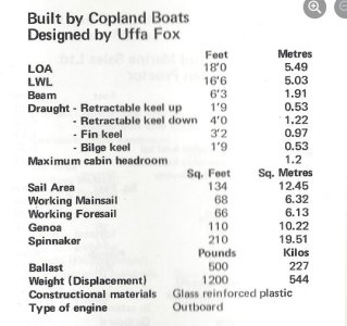

Hi, this is my measured height of Luff, J measurment and Mast (to hallard point).
Luff is 20ft (from shakle)
J value is 7.3ft
Mast to hallard is 19ft (to hallard).
This is about 69sq ft.
DOes this sound correct based on below?
In Ireland, so having trouble getting a sail still. I'velooked at sails for sale on FB but nothing much in Ireland.
Anyn idea if this would fit?
