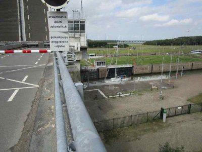

Volkerak commercial sluis

We bought our boat at the brokers Kappers which is alongside Volkeraksluis, as you say there is no lifting bridge at the pleasure boat sluis and quite a few yachts used the commecial sluis to get the opening bridge.
my 16.1 air draft is no issue @the volkerak slius, plenty of clearence under the fixed bridge

the volkerak sluis has a commercial sluis vhf control for permissionto use it
