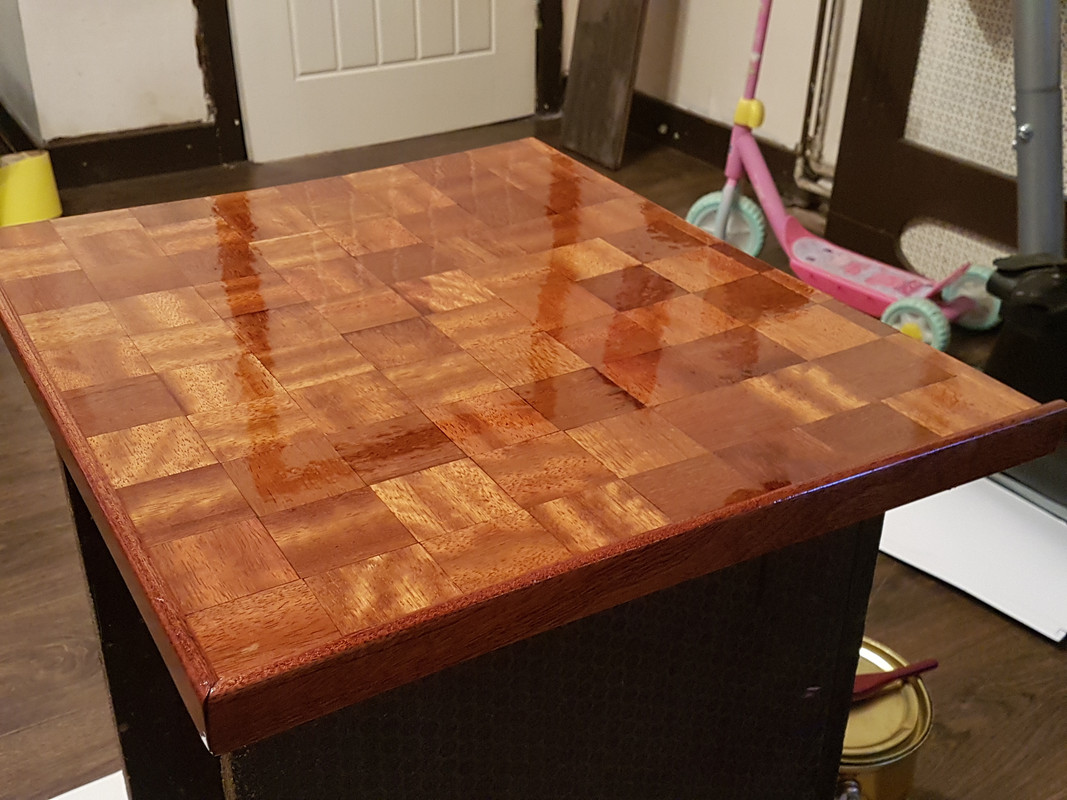

That looks the bees knees! Commissions?
I am not exactly a joiner more a faffer, well thats now my new name Captain Faffer as all i do is faff about. I had off cuts so made a table, now i like it i need to buy more Iroko and Sapele to make a berth table lol.
But thank ;):)
I don't like varnish which is too shiny because it can end up looking like plastic. Also it shows up every imperfection in the varnished surface and with my boat being over 50 years old it has plenty of imperfections! :eek:
With Le Tonkinois you can add something, i forgot now what but it gives it more of a matt finish.

You put yourself down too often. There’d always be a job here for you if you were closer! :cool:
I need a new table as I bought a “teak” table after seeing them at the Southampton boatshow and it was absolute garbage so ended up going back.
Gelomat Is what you add to the Le Tonkinois. We played around with it if I remember it was too expensive commercially but it is a lovely finish!

Thats the stuff Gelomat from Le Tonk. I may well try it on the interior walls if after three coats its to glossy. Dont want it to glossy all around.
What size design is this table you would want making ? Just curious at the minute ;)
