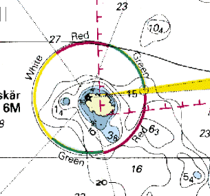

I know I'm exposing myself to ridicule but I now have the admiralty leisure portfolio for ramsgate to tower bridge.
On one, the port of Dover has yellow and red arcs (yellow is marked w for white I presume) around it and on the Gull Stream to Princes Channel chart 5606.4 there is a yellow arc east of North Foreland, a red arc north of Margate and another yellow arc through the Margate Sand.
My admiralty chart symbols book is on the boat and I've never seen these before so I'm stumped. Shell Channel Pilot shows the same arcs around Dover but doesn't explain the significance of red and white sectors and various books I have don't help.
I know its a basic question but help would be appreciated.

Sounds like sectored lights to me.

Yes, they would be 'sectored lights', as TK has it.
The idea is that, after you have positively identified the relevant light by its 'flash' characteristics ( do the course! ), then by sailing/motoring up the white sector towards the light, you remain in a sector free from reefy/rocky hazard - except for the bit the light is mounted on. At Dover, it's probably England....
Similarly helpful, if you identify the light OK, but you're in the Red Sector, you know from the chart and from the essential booklet Chart 5011 ( or Reeds... ) that you need to turn right to get into the white bit.
Some would say 'stop and retrace your steps very carefully' as you may already be in the ( rocky ) dwang.
The other major little matter is to remember to look over your shoulder at suitably-frequent intervals, for the approach of other users of the light's benificence. They are, in the vicinity of Dover, quite likely to weigh about 8,000 tons, carry cars and passengers, and be making 20 knots straight at you....

Don't remember any of the ones on the Clyde flashing at me...?
I think they are generally steady (in fact the one on the graphic above doesn't show any characteristics)

a steady light IS a flash characteristic, if you look at it from that perspective. If it's steady and not flashing, you can distinguish it from other nearby lights that are flashing.

As an example, going E in the Ardmore Channel past Rosneath Pont towards beacon "8N" at 55 59N 004 44W, the beacon is Fl.Y.3s with WRG sectors centred on 080deg. While steering precisely on line towards the beacon you see fixed W, but if you veer off to port or starboard you see alternating W&R or W&G respectively, while if you stray further from the leading line you get a fixed R or G. This, taken with the flashing R & G channel buoys, the isolated danger beacon at Rosneath Patch (Fl(2)10s), the Whiteforeland fairway buoy (LFl.10s) and the W cardinal (Q(9)15s) make the whole area resemble a fairground.
