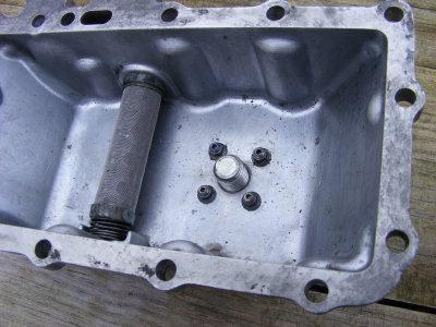

Hi Did you have a look at the pics of my sump mod #16, there are 2 links you will be able to see the internal arrangement of the sump filter, I think the engaging of the filter into the internal rear seal retainer is what give people grief and on occasion have lost the strainer inside the sump ! because I had access to remove sump anyway decided to do the mod so am able to drop the oil & leave it draining pretty much completely now without disturbing the strainer or buggering about with extractor pump suits me !
