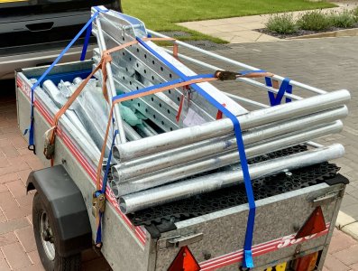

Google will find the usual suspects. Few hold stock so depending how urgent you may need to call to see what lead time is likely to be. I thought I was not going to be able to hire one for the yard this year and so had a search late summer - lead times varied as did cost probably; in the end I was able to hire. Things you need to consider beyond the basic size and cost stuff:
- ease of initial set up I’ve seen systems that claim “20 minutes” and one quote I got said “can easily be assembled by 2 men in one day!!)
- portability (which affects cost of delivery in first place but also flexibility to move yard, or reduce storage costs)
- happiness of the yard with the design, width is good for stability but not for packing boats in yards…
There were a lot of people reselling other people’s kit - but I couldn’t understand what value they brought, they didn’t hold stock, weren’t saving me on delivery cost, weren’t offering to set it up for me, and I found the big names (tennamast, yacht legs co, x-cradle and Jacob’s all perfectly happy to quote me direct).
