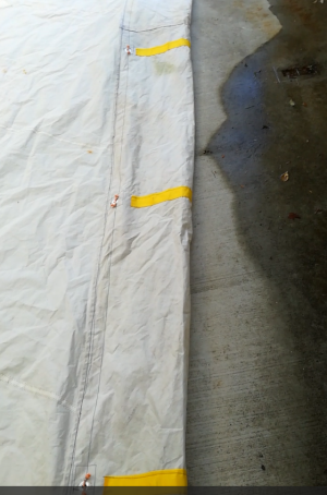

Wrap around jib on a furled genoa

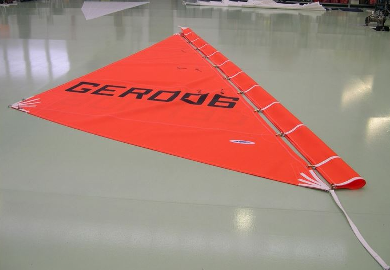

Nice one :) The professionally made ones I saw have a sleeve which uses the same jib hanks. Yours seems to use a thin line through grommets (?), will the sleeve remain closed in case of stronger winds -if the sail is supposed to be used such ?

RE; I saw have a sleeve which uses the same jib hanks.
This was a test run.
The line through grommets system worked when up, but not sure how strong that will be.
However, it took way too long to thread through and set up. Have to modify that.
I looked at reusing the original hanks but they are too small. Longer hanks are maybe an option later.

RE. using parrel beads, and Would big dyneema soft shackles
The idea of stress or rubbing points on the furled genoa bothered me. After all I was trying to preserve that sail.
Both exposed soft shackles and parrel beads rubbing on the genoa would defeat the purpose.
My first idea was to use soft shackles in (yellow 50mm tape) sleeves which I sewed onto my skirt in line with the grommets.
I thought that the stress would be spread by the skirt. Then I thought that those stress points would still be concentrated as wear lines on the genoa.
So I went for the threaded line.
When I tried it last weekend everything was floppy and difficult to thread through. This would be useless in heavy weather.
My next move will be to epoxy the end of the line so that it is rigid and will be easier to thread through the loops.
After that I am thinking of every second grommet with a soft shackle in combination with the threaded line and finally just soft shackles or lanyard and toggles through the sleeves.
Winter is long so I have lots of time to experiment.
