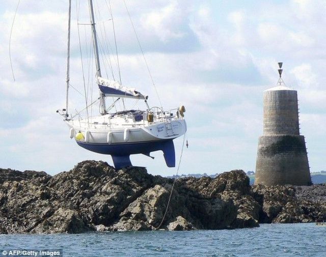

I also wonder whether a careened wing keel boat would float or fill with water when tide comes back, due to increased heel.
Not a worry for me as I start to panic in less than 10m as generally, in Scotland, it’s either 100m or zero metres - and not much in between.....
It is a possibility. Deeper twin keel designs might suffer that fate if they fell all the way over. Many traditional, narrow designs are subject to down flooding. From personal experience: a Folk boat will not come back up if dried out on her bilges.

Doesn't seem to be a problem.
I was waiting for someone to post that :)
One possible disadvantage that I don't think has been mentioned is the stress imposed when refloating if you dry out in deep mud.
If it's a problem, it would preclude the use of my club pontoon, where deep fins dry out quite happily, floating on the mud. Yes floating is the right word. I made the mistake of taking the log impeller out at low water once. I won't be doing it again...
